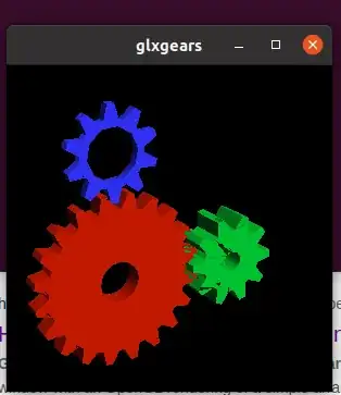

I'm using Ubuntu 20.10 in dual boot PC alongside Windows 7(32bit), just installed Ubuntu several weeks ago after RAM upgrade to 16GB. Everything works fine (after messy install) until several days ago, something happened... I see something wrong with the graphics, first noticed it in Minecraft, but then I found the issue in other applications too. This did not happen 2 weeks ago, and I don't remember what change I did that could mess with graphics drivers. Attached image is glxgears screenshot, which shows missing triangles.

The glitch even appears when I'm writing this question, see the image:

I have the same symptoms (documented them on the Ubuntu forums). The best answer I've found (from here) is that it's an issue with Intel integrated graphics (often HD 2500) and kernels between 5.8.0-49 and 5.12.5. Installing a newer kernel or rolling back to an older one has worked for a few people (see another example in my forum post). I haven't dared try it yet: the bug is a minor cosmetic annoyance (on my system at least), so I'm waiting a while to see if Ubuntu backports the fix or provides a new enough kernel before too long.
