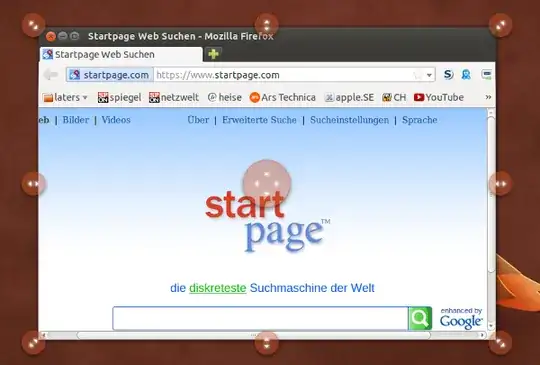

My workstation with Ubuntu 12.04 is a MacBook Pro which supports a Multitouch Trackpad.
Unfortunately, I'm constantly accidentally triggering the three finger touch gesture to resize a window:
How can I disable this gesture?
