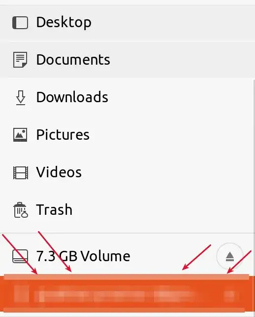

How can I access this repository from terminal? It is the access to my google drive account from the desktop. Is there a way to make it accessible from \home
