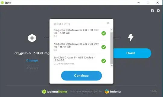

  • Use the pancake icon in Disks or use Etcher, Rufus, dd or mkusb, when you want to restore or clone the image to another drive.
For mass production, Etcher can flash an image to multiple disks at the same time.
