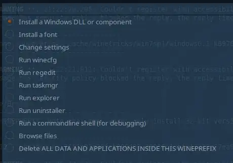

This is where I think I am hitting my snag. Finally, the tutorial says to Install a DLL. Here is the following screenshot:
Instructions#6
But Here, I get an error message and I don't know how to fix it:

Summary
You could try the following:
  1. Update to the latest version of winetricks.
  2. Rename the file as instructed in the message.
  3. Try installing again.
This has been successful for many people. Sources:
  1. Can't install DLLs in Winetricks
  2. winetricks sha1sum mismatch rename and try again
1. Updating winetricks
You can get your current version with
$ winetricks --version
and which is the latest available with
$ curl --silent --show-error https://raw.githubusercontent.com/Winetricks/winetricks/master/src/winetricks --stderr - | grep ^WINETRICKS_VERSION | cut -d '=' -f 2
20210206-next
If you don't have the latest, update and check with
$ wget https://raw.githubusercontent.com/Winetricks/winetricks/master/src/winetricks
$ chmod +x winetricks
$ sudo mv -v winetricks /usr/local/bin
or
$ sudo winetricks --self-update
Source: How do I get the latest version of winetricks on Ubuntu?
2. Renaming the target file
$ mv -v <filename> <filename>.bak
3. Installing again
Repeat the procedure.
