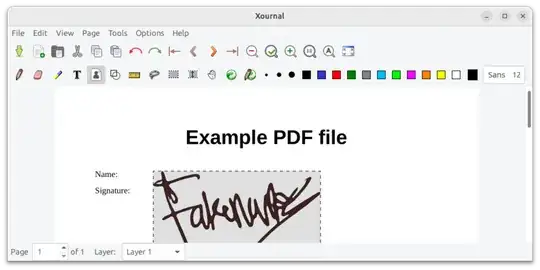

Using Xournal or Xournal++
How does one fill and sign PDF documents on a Ubuntu?
Not with Adobe unless you get them to add support for it.
Alternatives:
  • Install and open Xournal (not actively developed anymore):
    sudo apt install xournal
  • Or install and open Xournal++ (actively developed), sometimes written xournalpp:
    sudo apt install xournalpp
(See this for a comparison between the 2; xournal++ is a rewrite of xournal)
and then ...
  • Choose "Annotate PDF" from the File menu and select the PDF to sign.
  • Click the "Image" button in the toolbar
  • Click on document
  • Select an image of your signature
  • Optional: export to PDF so you have a new copy
Screenshot of Xournal

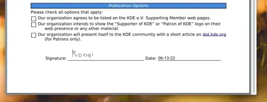

If you don’t want to take an image of your signature, you can use Okular: open the document, then choose Tools > Annotations and click on "Freehand Line" (the red scribble on the right of the pen).
Tip: to make it easier to sign on a laptop trackpad, temporarily disable the mouse pointer acceleration in your OS settings.
As pointed out by Archisman Panigrahi in the comments, Okular also has an "Insert signature" function to insert a scan of your signature. See this tutorial for more information on how to scan your signature.

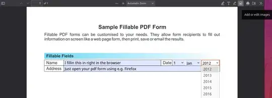

Use your computer's internet browser pdf viewer (PDF.js)
Sometimes the simplest answers are the best. Without the need to install anything, you can use PDF.js, the default pdf reader of your web browser. Firefox, as well as Chrome, use PDF.js - I am not sure about other browsers.
You can fill in your pdf forms, write custom text, highlight, and even add your signature image. Then print your adjusted pdf into a file and you are done.
