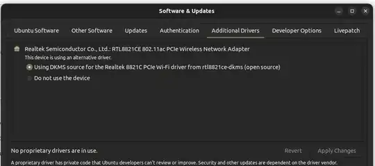

Steps:
  1. Open "Additional drivers" app
  2. Check additional drivers tab
  3. You can find your wireless device, make sure to select an option if it says "do not use this driver". In my case using dkms driver fixed the issue.
Note: if you don't see additional drivers, make sure to check this also. Install thirdparty software ubuntu
