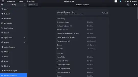

None of us can help you without knowing your version of Ubuntu. I didn't use Ubuntu/Lubuntu/Xubuntu for long time. That's why I don't think my answer will helpful or not. enter image description here. Workspace depends on gnome version also. You can change gnome version also. Here's an answer which may help you. How to check gnome version?. If you visit the link. Than, you will see that there's two type of desktop in Ubuntu not only in Ubuntu either. Some has workspaces Some hasn't... And, if you are facing issue with shortcuts than, you can add shortcuts in settings.. enter image description here
