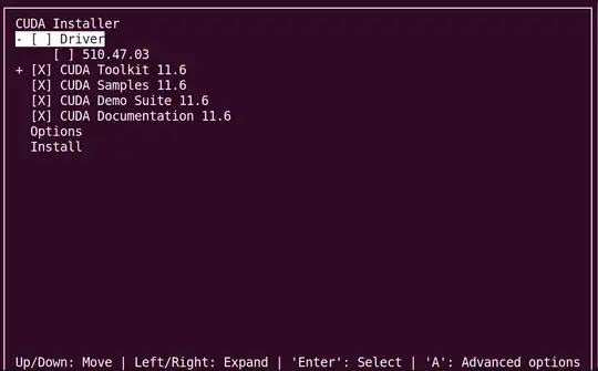

Adding to Alexander's answer about unticking the driver option - here's a screenshot where you can do this. (CUDA 11.6 runfile installation on Ubuntu 22.04)
CUDA Install disable driver installation
