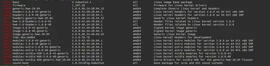

In addition, the numbers you are quoting look very strange. Please post the output of
$ uname -a
$ dpkg -l | grep ii | grep \ linux-
$ dpkg -l | grep rc | grep \ linux-

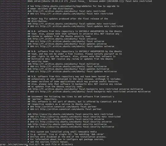

and the list of repos you have
$ grep ^ /etc/apt/sources.list /etc/apt/sources.list.d/*
