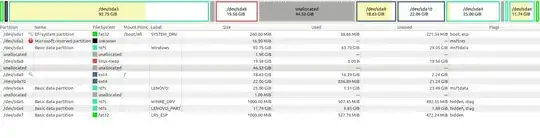

Why can't I resize the /dev/sda9 partition? I have plenty of unallocated space for it.
Gparted screenshot with unallocated space to the left of sda9

You can't resize a partition that is mounted. Thats why there are a key/lock symbol at it. /dev/sda9 is your root (/) partition.
Boot on a live media and run gparted from there.
