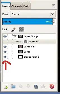

Gimp 2.8 will still toggle visible layers using Shift+Click on the eyeball, but now with layers within Layer Groups Gimp will respect layers that are invisible, or visible within a Group, There is a discussion here by developers - 1
What this means is that when you make a layer invisible within a group, it will stay invisible when toggling visibility of other layers and groups.
Before toggle and after toggle, I am toggling the visibility of the layer pointed to by the red arrow- enter image description here----------------enter image description here
Notice that the layer within the layer group stays invisible when toggling the other layers with Shift+Click

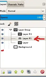

Now for the bad news, This also means that When trying to toggle the visibility of many layers Within a layer Group It does not work, only selecting the visibility of the group as a Whole, enter image description here
Notice that I am toggling the visibility of the layer pointed to by the red arrow, yet only the layers outside the group are affected.
I have not found any workarounds for this behavior yet.
