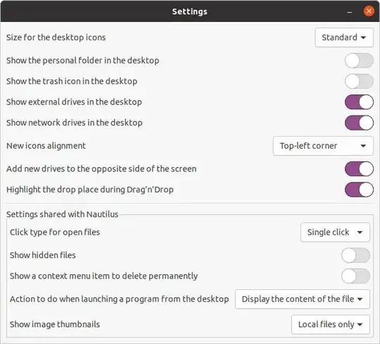

right click somewhere on the the desktop, select Settings and adjust the screen settings from there:
