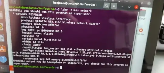

During the installation of Ubuntu 20.04 I remember the field where networks were supposed to show up actually showed my device (QCA6174 802.11ac Wireless Network Adapter) instead of the available networks. I remember clicking it thinking I would select the wifi network later on. When I run lshw -c network it shows *-network DISABLED for my wifi card.
I've tried looking for additional software within Ubuntu which shows there is no additional software. I've tried resetting the network management service and also manually creating a .yaml file using netplan. None of these options have worked. I am able to connect to the internet through wired connection. When I click the wifi options in Ubuntu it says unavailable, yet it seems like it's searching for networks. Ultimately it finds none.
