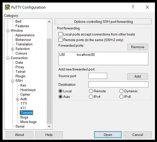

I have connected to my Pi using SSH using PuTTY, and I have added the tunneling as below: enter image description here
Now, when I go to localhost I can see the default apache page which is configured, but I am not able to find the gci webpage.
