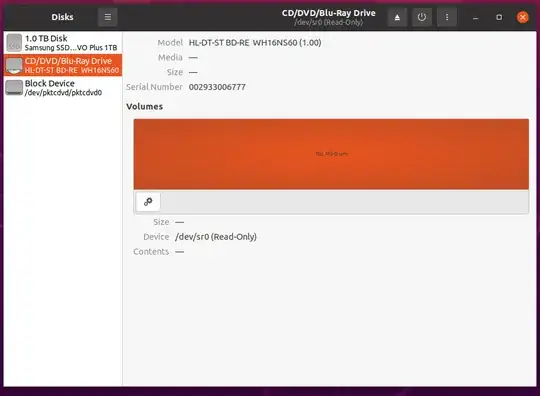

UPDATE
Here is the dmesg output when I connect the drive without a disc in it:

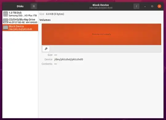

The Disks application will not start when a disc is inserted into the drive. When the drive is connected and empty, I get the following display:
