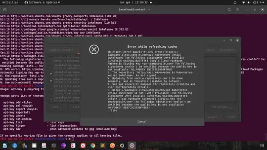

I have tried with sudo apt-get update and sudo apt-get upgrade. And i get this error with kubernetes error: I have tried with these following commands below:
sudo rm /var/lib/apt/lists/* -vf
sudo apt-get clean
sudo apt-get update
But it hasn't worked! How can i fix this? Is it that i must get the key somehow?

I found an answer that helped me:
Just write:
sudo su
Login as root and after that:
curl https://packages.cloud.google.com/apt/doc/apt-key.gpg | apt-key add -
