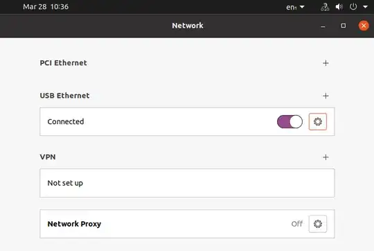

enter image description here This is info of my hardware :

The problem come when RTL8111/8167/8411 showing on my system
