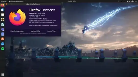

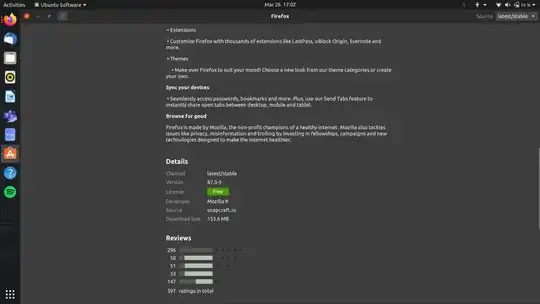

I have recently dual booted my windows with ubuntu 20.04. And with that I have got firefox pre-installed but when I go to the app store, I see another firefox. I don't understand the difference between the two. Is one better than the other or are they the same?
screen1
screen2
screen3
They are the same or 1 is a predecessor of the other.
So note the SNAPCRAFT reference with the 2nd as this denotes that the installation is method using snap.
You can install different firefoxes from
  • regular Ubuntu apt repository
  • snapstore
  • directly from Mozilla
Depending on versions and packaging those can be 3 different installs.
