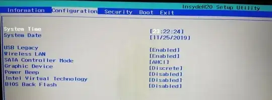

@Irsu85 reminded me of another issue you might be facing. This happens for new laptops with an SSD. I was unable to dual-boot my newly purchased Lenovo Flex 15 2-in-1, which had an SSD.
Steps to fix:
Go to
Setup Utility(press F12 or F2 on startup) -->Configuration-->SATA controller Mode. Set it toAHCI.Dual-boot it as usual.
Note: Keep mode as AHCI permanently, don't switch it back after installation.
Took me around 2 days to figure it out. Intel RST(Optane), the default option, actually slows down a system with an SSD.
