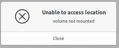

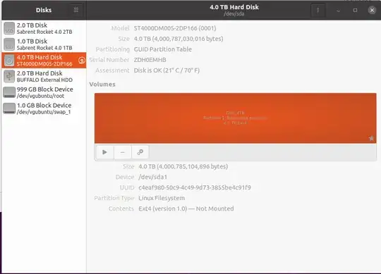

The original problem was that a new disk that I installed a month ago, did not mount after a reboot, yes a month later. From Disk UI, I click "mount selected portion" and nothing happens, no error reported. Also, from Disk UI, I click the gears icon, then I click "check Filesystem..." and it returns "Filesystem Disk_4TB on ST4000DM005-2DP166 is undamaged.".

SOLVED Wayne observed that /Disk_4TB in fstab had 2 entries with different UUIDs?
I once installed the disk with one of those docking stations before later installed it internally. This creates a second entry in fstab with different UID.
Disk UI did not complain about the conflicting stale entry and succeeded in mounting it the first time around. Subsequent reboots is when this conflict kicks in.

Mount point /Disk_4TB is listed in /etc/fstab with two different devices. Only one entry per device/mount point is allowed.
