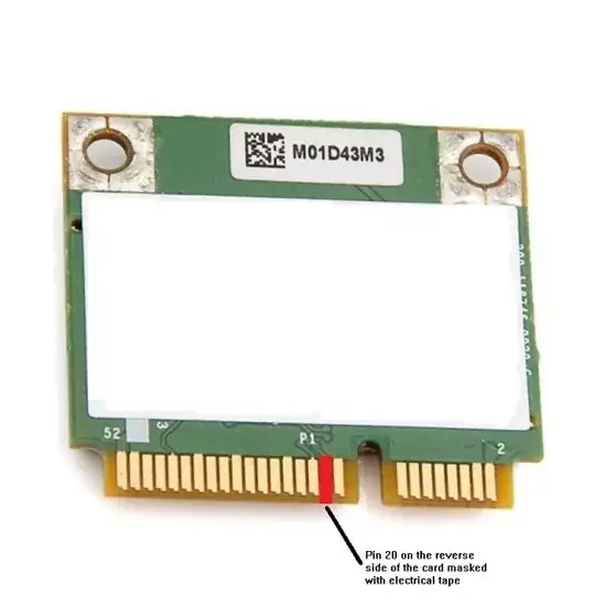

masking pin 20 of the pcie card Not an Ubuntu/software related solution..it is hardware related.. For the hp 15 series of laptops(old ones), if any one facing similar issue and tried all the above steps, then it is cz of the wifi card malfunction..it sends an off signal..to the input slot.. Os interprets it as a hardware switch.. In my case the card is already dead... both the wifi and Bluetooth, and I'm using an external adapter.. So I simply remove it (not simply, cz hp 15 series are quite hardly assembled, reaching inside takes some effort, but can.. if you got a nice set of screw drivers). get [your model no] manual pdf.. follow it to reach out to wifi card.. [If you didnt want to unplug the card, mask the pin 20 (as in picture - of total 52 pin connector, odd-even pins on both sides) use an insulation tape then cut it with blade to achieve good masking of the pin, refer the comment for details, and also visit this page to get more details on mini pci3 connector] and finally thanks @chili555 for the driving comment..

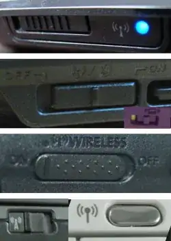

hard blocked it is a physical problem... usually. Possibly you have switch button on the laptop case

My Ubuntu 20.04 running on an old HP Elitebook 6930p similarly had no WiFi. lshw -class network showed the built-in WiFi Intel PRO/Wireless 5100 AGN [Shiloh] as "unclaimed." Tried many things from several AskUbuntu answers, including resetting BIOS to defaults, with no success. On the HP Elitebook 6930p the "WiFi hardware button" is a touch sensitive area just above the F5 key on the keyboard; the "button" is the antenna icon/light, if it's steady orange then WiFi is disabled.
After booting Ubuntu 20.04.5 from a live flash, I saw it was in Airplane mode, and I could touch/press that spot/button and it would change to blue (on) and I had WiFi. So I think somehow on my Ubuntu installation it was in Airplane mode and stuck there because that "button" was disabled. This would also explain why inserting a TP-link USB WiFi adapter didn't work.
