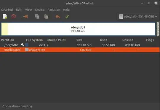

EDIT2: The pictures from Gparted are here https://i.sstatic.net/8kYwp.jpg The first one(with 930.4 Gib) is the external drive B:
and the second is external drive A(the one that i cant enter):
As I said, i cant boot from external drive A, only from B or internal drive.

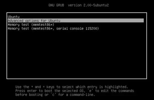

The page i see when i plug in external drive B is almost like the third picture i found online:
The only difference is that it has the option "Windows boot manager" below the option ubuntu.

The Issue is not mount-point
If I understand your problem correctly, the issue is not changing the mount point of Drive A to /. When you installed Ubuntu in Drive A, the correct mount point was assigned. However, when you installed Ubuntu in Drive B, some information in the internal EFI System Partition (ESP) was overwritten and updated for Drive B.
This is why you can boot from drive B and drive A does not boot any more.
The Solution is to have ESP in all the drives, A, B, and the internal drive (it is already there).
You have to install ubuntu in Drive A and Drive B again. See Installing Ubuntu in a external hard drive and NOT placing GRUB of my C: hard drive for how to go about doing that.
Repeat the process for A and B.
Finally you have to remove the part of Grub installed in the internal ESP partition. See this answer for how to do that:
Can only boot Windows 10 through grub. How do I disable this?
Once all these are done, it will work a bit differently when it comes to booting from Drive A, Drive B or Internal drive (Windows). Windows will boot by default. When you want to boot from drive A or B, you will have to press the key to select the boot device. This can be F10, F12, Esc, or some other key. This is the same key you press to boot from the Live Ubuntu installation USB. Once you press the key you will see option to boot from the USB drive in UEFI mode. Select that and the computer will boot from Drive A or B.
