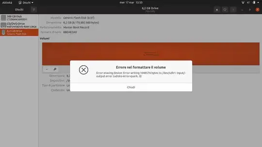

I try to format an old usb drive that I didn't use for a long time, but I am not able to do it , either using disk or using gparted. enter image description here

this is the last part of the output of dmesg:

[15093.653603] sd 5:0:0:0: [sdb] Attached SCSI removable disk
[15210.713521] sd 5:0:0:0: [sdb] tag#0 FAILED Result: hostbyte=DID_OK driverbyte=DRIVER_SENSE cmd_age=0s
[15210.713525] sd 5:0:0:0: [sdb] tag#0 Sense Key : Not Ready [current]
[15210.713539] sd 5:0:0:0: [sdb] tag#0 <<vendor>>ASC=0xff <<vendor>>ASCQ=0xff
[15210.713542] sd 5:0:0:0: [sdb] tag#0 CDB: Write(10) 2a 00 00 00 20 00 00 00 f0 00
[15210.713545] blk_update_request: I/O error, dev sdb, sector 8192 op 0x1:(WRITE) flags 0x4800 phys_seg 30 prio class 0

I also try with a different OS , Win10, and it is also unable to format the usb telling me that the filesystem of the usb drive is read-only.
Is there any chance to format and make usable again the usb? Thanks a lot
