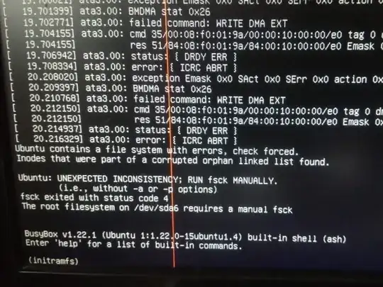

I was watching movie on Amazon Prime and suddenly screen started stuttering. Not only that, it also does that on other video streaming websites. The video goes into a loop and nothing works. It does not shutdown, so i have to restart manually. Then on reboot, I get the initramfs error. I am talking about this error.
I found the solution here.
So my question is:-
  1. What is the root cause of this error as I got it twice in a day.
  2. Is there something wrong with my hard-drive or with the processor?
  3. How to prevent this error?
A bad disk probably.
(where it lists sda replace it for your device: see fdisk -l for instance)
After you get to a working system or from a live session do a ...
sudo apt-get update && sudo apt-get install smartmontools
sudo smartctl -c /dev/sda
to install smartmontools and let it show how long a test is going to take and then do a
sudo smartctl -a /dev/sda
to show any problems.
This can be used to create a list of badblocks:
sudo badblocks -v /dev/sda > badblocks.txt && more badblocks.txt
The more the worse the state of the disk.
The more issues the better it is to replace it.
