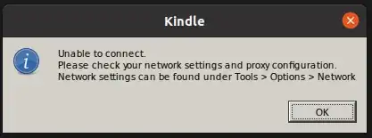

I'm running Ubuntu 20.04 and successfully managed to install the Kindle App v.1.17 via wine, launching it very easily. However, I am greeted with the following message even though I'm connected to the internet:

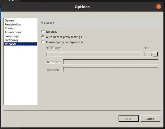

In the tools, the network configurations essentially comprise the proxy settings, defaulted to auto-detection.
Is there anything I can configure to make it run or is this version already phased out? If so, are there any workarounds to use DeDRM with Ubuntu?
I can't post a "comment," but this is not an "answer" per se... it's progress toward an answer. I have found a couple other communities that have had the same problem and report that they have solved it by replacing an untrusted certificate. Details here:
https://bugs.winehq.org/show_bug.cgi?id=50471
https://forums.linuxmint.com/viewtopic.php?f=47&t=342186&uid=248652
If I were comfortable enough with certificates to talk authoritatively on the topic, I would post instructions. For now all I can do is leave this info in the hands of the more experienced.
[EDIT:] Ok, I have a procedure that works, but for all I know could leave one susceptible to security issues. It goes:
1: Verify that the file /etc/ssl/certs/b204d74a.0 is not there
2: Comment in the line mozilla/VeriSign_Class_3_Public_Primary_Certification_Authority_-_G5.crt in the file /etc/ca-certificates.conf
3: Create a file called /usr/share/ca-certificates/mozilla/VeriSign_Class_3_Public_Primary_Certification_Authority_-_G5.crt that contains this certificate block:

4: Regenerate the certs using the command sudo update-ca-certificates
5: Verify that there's now a file called /etc/ssl/certs/b204d74a.0 which links to your new cert
This worked for me. KindleForPC version 1.15 running on wine now connects up again.
Charles
  • 111
Ubuntu 20.04 LTS with PlayOnLinux 4.3.4 with Kindle 1.17.1 . Solved the issue. Downloaded several books with everything appearing to be working properly.
Used nano in terminal to write (copy) the certificate and do the edits.
Thanks for taking the time to figure out a solution and being willing to share it. Greatly appreciated.
