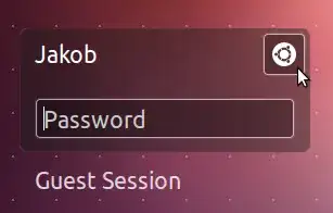

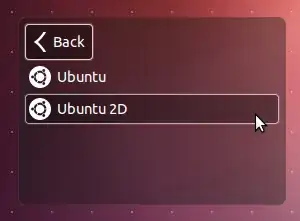

To run Ubuntu without, choose "Ubuntu 2D" on the login screen:
