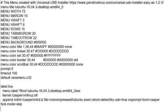

Following is how I modified a Universal-USB-Installer-2.0.0.0 Lubuntu 16.04 install to use Syslinux to boot to the HDD in BIOS mode.
  • Open /uui/syslinux.cfg in Notepad.
syslinux.cfg enter image description here
  • Directly after the first menu label add:

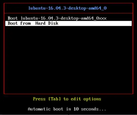

The option to boot from Hard Disk should now be on the start menu.
Some versions of UUI locate syslinux in the root folder, in that case copy chain.c32 to the root folder.
