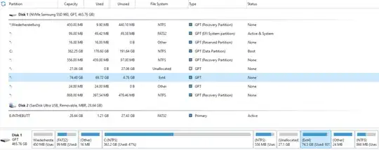

My current situation;
I have tried to shrink down C: and add the resulting space to my Ubuntu partition. I've done this using Windows (which was probably the biggest mistake) and in the process I moved the "unallocated" space from the end of C: to the beginning of the Ubuntu Partition (the one with filesystem Ext4). My current Situation
Apparently Ubuntu does not boot anymore because the superblock is not found by GRUB. The partition is not mountable due to possible corruption on a live Ubuntu I bootet to. HELP

Re-allocate the memory to its original state and then try to boot into Ubuntu. Should work. Then Partition again using Gparted in Ubuntu.
Who believes this?! I was successfully by running fsck If you still can, only proceed with a Backup
