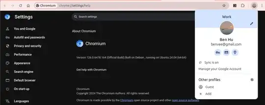

As of today, 2024 Xmas holidays, it is back. enter image description here
