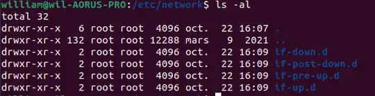

interfaces do not exist in /etc/network

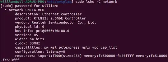

Results of lshw -C network :
lshw -C network

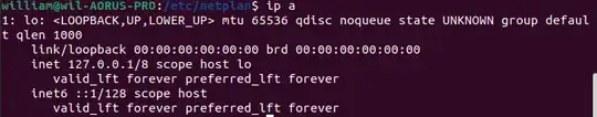

Results of ip a :
ip a
