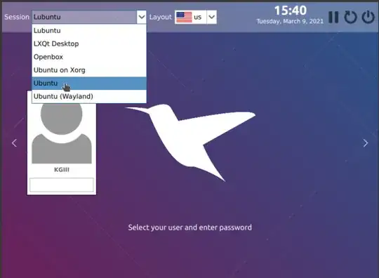

At the login screen, look up at the top where it says 'Session' and use that drop down menu to select the newly installed Ubuntu desktop. It will look similar to this, though probably at a different resolution. (I did this in VirtualBox.)

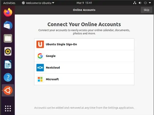

Then, enter your password and login. It should look like this:
