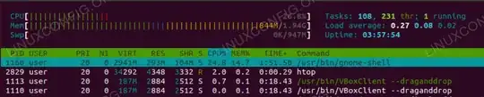

Online I found the following figure where you can see "CPU" as first row and it should represent the total amount of the used CPU.
Amongst the options of the htop I run on my PC there isn't the above CPU option. Where can I find it?

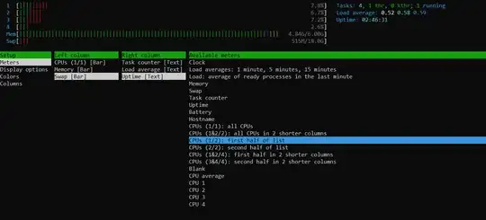

You can go to settings with F2 then move right with your right arrow key then select how you want the CPU displayed by using space then F10 to save.

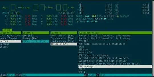

  • press f2
  • down arrow twice to select Meters
  • right arrow three times to select available meters
  • keep going down with down arrow and search for CPU Average
  • press Enter to add
  • press left arrow to shift the meter to column 1
  • up arrow to make it the first entry
  • press space to change the style
  • press enter to lock
  • press f10 to save the layout. If freezes, use the mouse and click in f10-done
  • press f10 to quit
  • restart htop typing htop
Layout should be saved. Below image attached for clarity:
