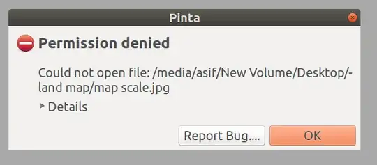

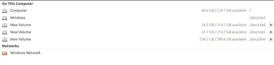

My ubuntu 18.04 is installed in the SSD.I installed pinta from ubuntu software but can not open files from my hard disk, says permission denied. But can open files from SSD where ubuntu is installed(Document, Download... folders). How do i give permission to all the drives. Facing same problem with some other apps too.
Files from Computer is accessible to pinta.
Here is the findmnt | grep /media command output
When I click Details I get the following information:
System.UnauthorizedAccessException: Access to the path "/media/asif/New Volume/Desktop/o1.jpg" is denied.
  at System.IO.FileStream..ctor (System.String path, System.IO.FileMode mode, System.IO.FileAccess access, System.IO.FileShare share, System.Int32 bufferSize, System.Boolean anonymous, System.IO.FileOptions options) [0x0019e] in :0
  at System.IO.FileStream..ctor (System.String path, System.IO.FileMode mode, System.IO.FileAccess access, System.IO.FileShare share, System.Int32 bufferSize, System.Boolean isAsync, System.Boolean anonymous) [0x00000] in :0
  at System.IO.FileStream..ctor (System.String path, System.IO.FileMode mode, System.IO.FileAccess access) [0x00000] in :0
  at (wrapper remoting-invoke-with-check) System.IO.FileStream..ctor(string,System.IO.FileMode,System.IO.FileAccess)
  at Pinta.Core.GdkPixbufFormat.Import (System.String fileName, Gtk.Window parent) [0x00001] in :0
  at Pinta.Core.WorkspaceManager.OpenFile (System.String file, Gtk.Window parent) [0x0003d] in :0

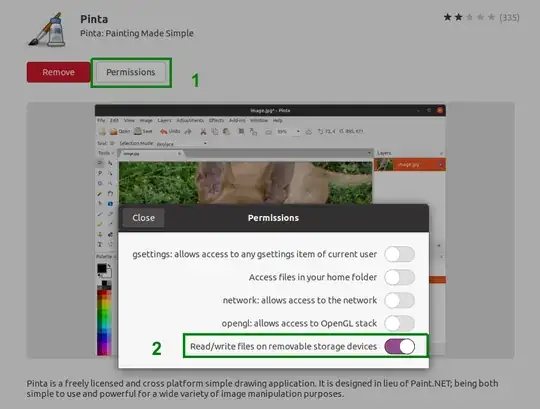

You have snap pinta-james-carroll installed.
Please read this and this
Solution
Either, remove pinta-james-carroll like so:
sudo snap remove pinta-james-carroll
Then, install pinta from snap like so:
sudo snap install pinta
Then, set permissions in Ubuntu Software like so:
Or even better, remove snap pinta-james-carroll like so:
and if you have installed snap pinta, remove it as well like so:
Then, install pinta from the official repositories with APT like so:
sudo apt install pinta
