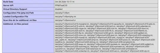

Latest note: it partially works, but PHP pages still not shown correctly.
The PHP pages are shown correctly now and the MySQL connection test works. After I entered a2enmod php7.4 which should have switched to Server API Apache 2.0 Handler get the error below but switched to FPM/FastCGI.
Besides is capture here for future references it was 3 nights of work: enable/disable modules, dependencies conflicts, updates, configurations and logging. Copy&Paste from other posts always sucks. Thanks!
SOLVED

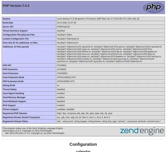

If you've done everything here, you should see PHP working as expected - this is phpinfo on my test env running 20.04:
