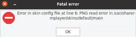

but when I run gmplayer, I see "Error in skin config file at line 6":
That file actually doesn't exist (There is one called main.png though)

This is an old issue that I thought had been resolved? However I can confirm that it occurs on my 20.04 system as well. The fix is easy enough and is drawn from the linked bug report:
First install imagemagick:
sudo apt-get install imagemagick
Then convert all the png files in the 'default' skin directory to the correct format. Change to this directory as follows:
cd /usr/share/mplayer/skins/default
And then run the following loop:
do
sudo convert $FILE -define png:format=png24 $FILE
done
This resolved the issue on my system and should also work on yours...
