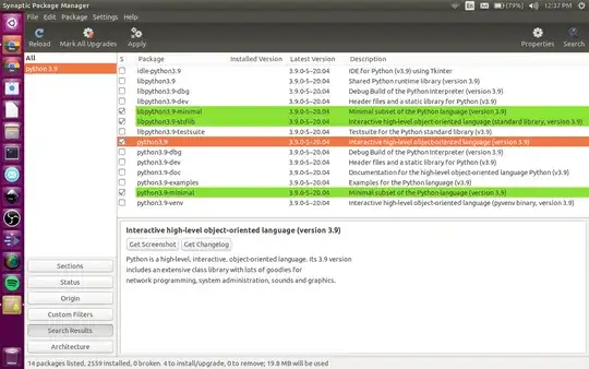

Install synaptic using
sudo apt update
sudo apt-get install synaptic
Then, open synaptic and click on search button. Type "Python 3.9" and press Enter. Now click on the box next to python3.9 and click on mark for installation. On top click on Apply button.
see image
