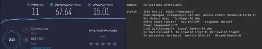

After reboot speed.
watch iwconfig
Wifi speed after reboot
After some time. It may seem that the Internet speed is normal, but at the beginning of the test the speed was 2-3 Mbps, then it began to grow to 50 and at the end it was 60. This can be seen on the chart.
Next test. enter image description here enter image description here
