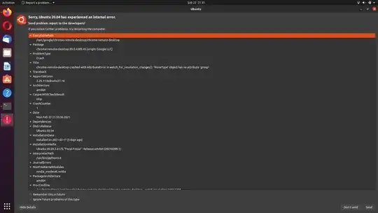

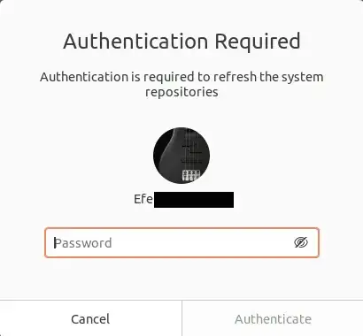

Today, I have installed Chrome Remote Desktop to my Ubuntu 20.04 LTS machine. However, when I restart my machine, I was asked my password for couple of Authentication Required popups. I was also unable to change my screen brightness (this issue is resolved when I remove my computer from Chrome Remote Desktop). However, the popup thing remains the same. Also, an error message appears everytime I start my computer. How can I solve it?

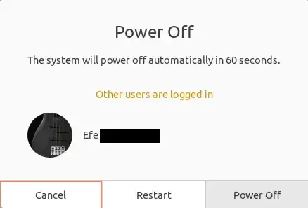

Also, when I try to shutdown the computer from GUI, there is an "Other users are logged in" warning in the popup. I have never seen it before. PowerOff

A more targeted polkit change that works for me on Ubuntu 20.04 is:
[Allow Network Manager for Myself]
Identity=unix-user:USERNAME
Action=org.freedesktop.NetworkManager.*
ResultAny=yes
ResultInactive=yes
ResultActive=yes
[Allow Login, Shutdown, Restart, Etc for Myself] Identity=unix-user:USERNAME Action=org.freedesktop.login1.* ResultAny=yes ResultInactive=yes ResultActive=yes
[Allow Colord all Users] Identity=unix-user:* Action=org.freedesktop.color-manager.create-device;org.freedesktop.color-manager.create-profile;org.freedesktop.color-manager.delete-device;org.freedesktop.color-manager.delete-profile;org.freedesktop.color-manager.modify-device;org.freedesktop.color-manager.modify-profile ResultAny=no ResultInactive=no ResultActive=yes
[Allow Package Management all Users] Identity=unix-user:* Action=org.freedesktop.packagekit.system-sources-refresh ResultAny=yes ResultInactive=yes ResultActive=yes
Which I names as /etc/polkit-1/localauthority/50-local.d/45-remote-desktop-sanity.pkla
Of course replace USERNAME with your username, and then restart.
