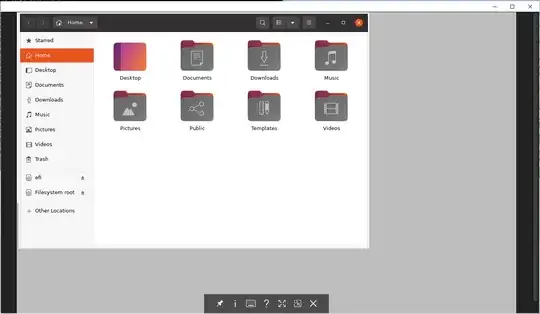

I installed TightVNC on a Ubuntu20.04* machine in order to use it remotely from my macbook pro. I have followed this tutorial,
And it works with the fce4 desktop. However I have a black screen whenever I try to use the gnome desktop with it: I tried to change the config follwing this issue, but nothing seems to work.
Here is ~/.vnc/xstartup

Furthermore, I Have the error message on my blackscreen:
Could not update ICEAuthority file /run/-/user//-ICEAuthority
It is probably a config or a rights error, but after two days of playing around, I am starting to lose faith.

I got it with uncommenting "WaylandEnable=false" from /etc/gdm3/custom.conf
Then
sudo apt update
sudo apt install xserver-xorg-video-dummy
sudo cp /etc/X11/xorg.conf /etc/X11/xorg.conf.bak # this file may not exist so if there is an error, it can be ignored
sudo cp /etc/X11/vncserver-virtual-dummy.conf /etc/X11/xorg.conf
Note: Following these steps will result in any connected monitors displaying a blank screen. If you need to use a monitor, run sudo mv /etc/X11/xorg.conf /etc/X11/xorg.conf.dummy and reboot
