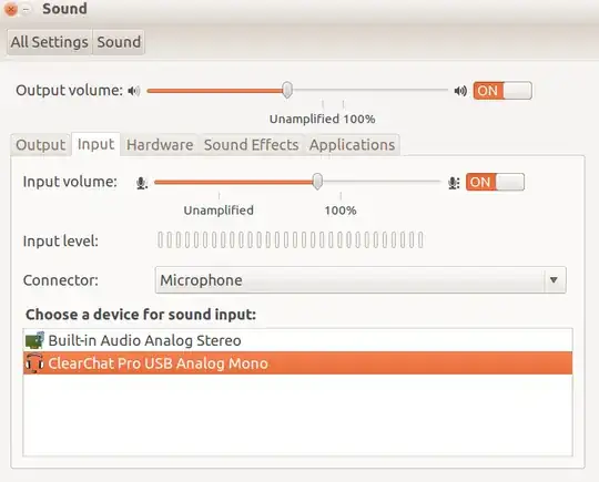

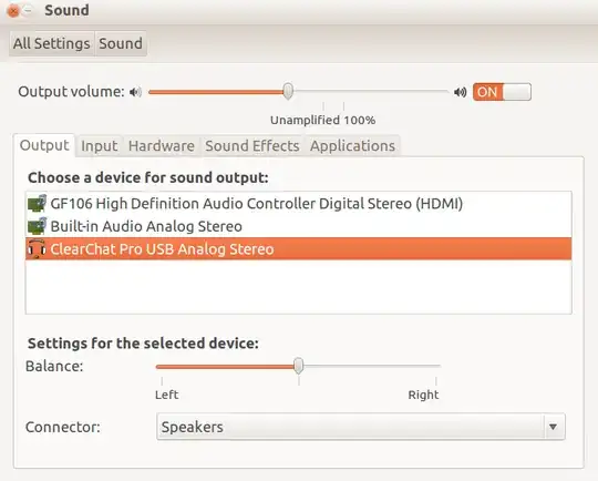

Finally the headset is usable now. I just did an update recently, also additionally I've updated from the ppa:ubuntu-audio-dev/ppa
sudo add-apt-repository ppa:ubuntu-audio-dev/ppa
sudo apt-get update; sudo apt-get dist-upgrade -y
Now the usb headset is on the input and output tabs. input tab

I opened system settings->sound. In that open Hardware tab. It shows logitech USB headset. Now click on Test Speakers, Front left, right. After this I able to get the audio from the headset.
