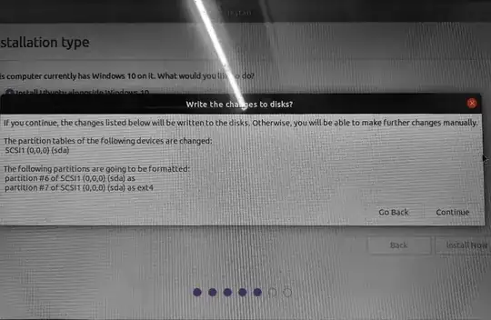

partition #7 of SCSI 1 (0,0,0) (sda) as ext4

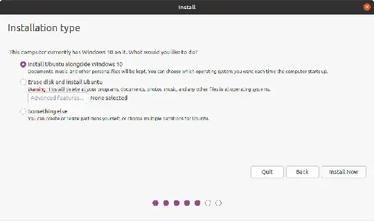

What happened was it detected Windows 10 this time and also offered to install Ubuntu alongside it, but the option was to directly install Ubuntu (rather than continue and customize the partitioning as seen in online tutorials). The options after selecting Something else showed the unallocated space, but I went on with the default install alongside option, and installed it.
