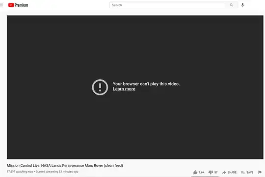

I cannot play YouTube "Live" vidoes with Firefox 79.0 (64-bit) on Ubuntu 20.04.1 LTS. I tried to fix the issue by enabling "Play DRM controlled content" in Firefox settings and also installed ffmpeg "sudo snap install ffmpeg". I can watch regular YouTube videos just fine.
I installed Opera browser and have no trouble watching YouTube Live videos with Opera.
Here is a screenshot of the Youtube error I'm getting in Firefox:
Here is the debug info from YouTube:

  "debug_error": {
    "errorCode": "html5.unsupportedlive",
    "errorMessage": "This video format is not supported.",
    "Jx": "HTML5_NO_AVAILABLE_FORMATS_FALLBACK",
    "aj": "",
    "sG": "buildRej.1;a.1;d.1;drm.0;f18.0;c18.0;f133.1;f140.1;f242.0;cAVC.0;cAAC.0;cVP9.1;a6s.0"

graham
  • 13,061
The OP found that by configuring Multiverse reference here and installing ubuntu-restricted-extras:
sudo apt-get install ubuntu-restricted-extras
that the issue was resolved.
