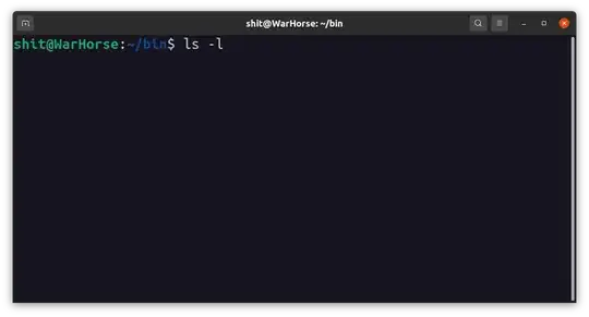

In normal mode(after pressing Escape)

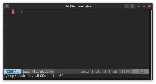

And I press "v" and I'm in vim :(

There is no visual mode in Bash's Vi-mode. A v in normal mode dumps the current line in the user's preferred editor. One types/edits the command there and upon saving and quitting the editor (in Vim, :x or :wq), Bash issues the command.
To disable the binding you can rebind it to an unnoticeable operation. Just add this to the ~/.inputrc file:
set keymap vi-command
"v":redraw-current-line
