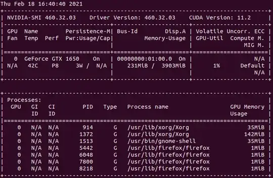

The following is the output of nvidia-smi command:
Output of nvidia-smi command

Two proposed solutions:
Update Graphics Driver
Confirm that the graphics driver for your GPU is up-to-date.
Use the Proprietary NVIDIA Drivers
It appears to me that some users aren't able to use Blender with the Nouveau (open-source) driver for NVIDIA GPUs.
The solution may be to switch by using the official NVIDIA (proprietary) drivers instead.
For Nvidia there are open source (Nouveau) and closed source (by Nvidia) graphics drivers. Blender functions best with the closed source drivers as they are more optimized and complete.
Blender documentation for Linux - Nvidia Drivers
There is an open source driver managed by a group of developers that are unrelated to NVIDIA, called Nouveau, and that driver doesn’t support Cuda.
Cuda only works with the proprietary driver…
NVIDIA forum - Can CUDA operate with open source Nvidia driver or only with Nvidia proprietary driver?
Ensure then when you try this, you're getting the latest version compatible with your GPU.
sudo add-apt-repository ppa:graphics-drivers
sudo apt install nvidia-460
This installs what appears to be the latest drivers for the GTX 1650, may require a restart after installation.
Reference: NVIDIA Driver Download: Linux x64 (AMD64/EM64T) Display Driver
