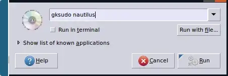

Well, for security reasons, /var/www folder is usually only accessed via sudo. If you wish to drop your files, let's say: your index.html, images folder and other stuff inside of it you will be in the need to start nautilus (or your preferred files browser) with elevated privileges by running sudo nautilus in a terminal or gksudo nautilus in the "Run application" dialog window, this will cause the /var/www to be accessed with both read and write access.
