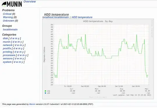

However, looking at munin output in my browser, I see only the HDD temperature chart:
How can I make munin also monitor & display the CPU core temperatures?

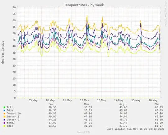

Result
Now munin shows all my CPU + other system temperatures:
weekly temperatures chart
