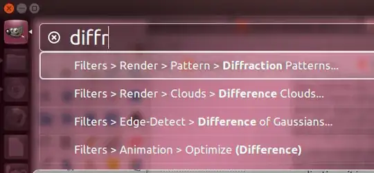

  • Use Case: GIMP
    I did not know where some options were in the menus of sub-menus but I knew what they were called and in some cases I only knew part of the word. HUD saved me time by just typing a part of the word and found what I was looking for. Here is the example of it (I was looking for the Diffraction Patterns option):

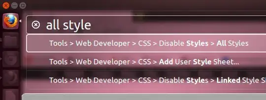

    In Firefox I am trying to access a Web Developers Addon option about clearing all styles from web pages when I view them. This is a 3 to 5 click menu option depending on how you get to it. With HUD is faster.

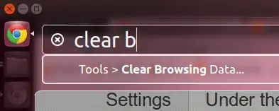

    In Chrome I am trying to clear the history and other stuff. HUD made it easier.

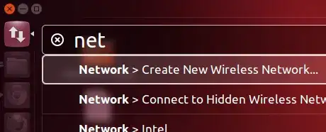

  • Use Case: Wireless Network Sharing
    To create a Wireless Network Share you just type Net and the first option is the one.

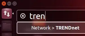

  • Use Case: Connecting to Known Wireless Hotspot
    I wanted to connect to the Wireless Router in the house so I...

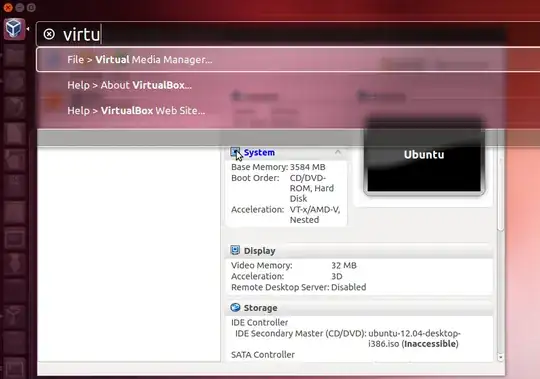

    Even works with 3rd party apps like VirtualBox:

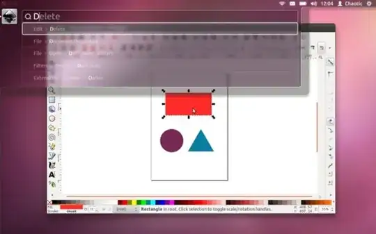

A screenshot of HUD:
