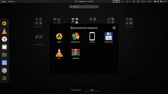

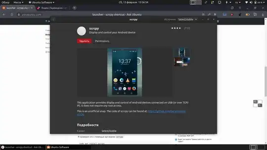

I installed scrcpy and created a shortcut, but the program only runs from the store, how do I create a shortcut with a working startup code ?
enter image description here enter image description here enter image description here enter image description here
The code from here doesn't work...
No application launcher for scrcpy

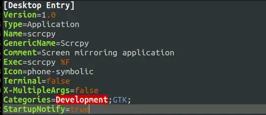

[Desktop Entry]
Version=1.0
Type=Application
Name=scrcpy
GenericName=scrcpy
Comment=Screen mirroring application
Exec=scrcpy %F
Icon=phone-symbolic
Terminal=false
X-MultipleArgs=false
Categories=Development;GTK;
StartupNotify=true
When I click on a manually created shortcut... in the tray, the animation circle just turns and disappears.

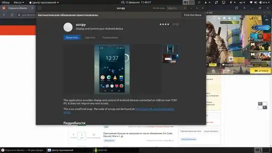

The program works only by clicking on the launch button in the GNOME store.

The store collects the information and builds my server:
gnome-software-service.desktop[7737]: INFO: scrcpy 1.17 <https://github.com/Genymobile/scrcpy>
gnome-software-service.desktop[7788]: [100%] /data/local/tmp/scrcpy-server.jar
gnome-software-service.desktop[7788]: /usr/local/share/scrcpy/scrcpy-server: 1 file pushed. 8.6 MB/s (34930 bytes in 0.004s)
kernel: [
kernel: [
kernel: [
kernel: [
dbus-daemon[
dbus-daemon[
gnome-software-service.desktop[7790]: [server] INFO: Device:
gnome-software-service.desktop[7737]: INFO: Renderer: opengl
gnome-software-service.desktop[7737]: INFO: OpenGL version: 3.0 Mesa 20.0.8
gnome-software-service.desktop[7737]: INFO: Trilinear filtering enabled
gnome-software-service.desktop[7737]: INFO: Initial texture: 1080x2336
Most likely, it should already be a program and not just a shortcut.
