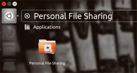

Go to Dash Home search for personal file sharing. If you don't have Unity installed, you can open the program from a terminal with typing gnome-file-share-properties in it.

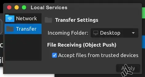

  4. Click on the new bluetooth applet indicator and select Local Services from the menu.
  5. Tic the box for Accept files from trusted devices > select a default destination folder > and then click Apply.
screenshot of the popup window for the Local Services options with the box ticked for Accept files from trusted devices. you also need to select a destination directory at this point or it will not allow you to click apply (not shown).

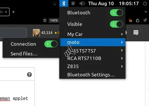

  1. Go back to the [other] system default bluetooth menu > hover your mouse cursor over your Phone/device > and toggle Connection before you send the file to Ubuntu.
screenshot showing the dropdown menu from the default system bluetooth menu with the mouse cursor hovered over the phone/device and the switch is toggled for "Connection"

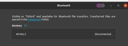

Bluetooth Settings on Ubuntu 20.04
On Ubuntu 20.04, remember that you have to keep the Bluetooth Settings open in order to receive files, otherwise Ubuntu will reject all transfers.
